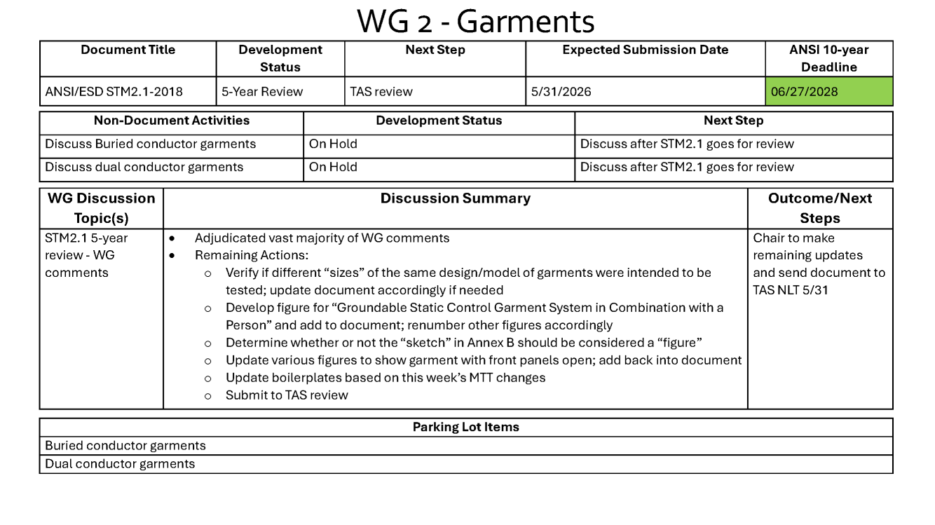

The WG discussed the 5-year review of STM2.1 “Garments – Resistive Characterization” document and decided that some changes are needed to the appendix to correct incorrect information. A drawing and recording chart for ESD coveralls will be added. These are mentioned in the body of the document but there is no chart for listing test points and recording them. Changes will be sent to WG before the end of July for review.
It was also noted that additional items such as bouffants, face coverings, hats, etc., will be considered for addition to the STM or to TR later.
WG discussed the 5-year review of STM2.1 “Garments – Resistive Characterization” document. Discussion focused on whether any changes need to be made, such as adding full overall suit drawing and test locations in an appendix.

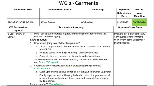

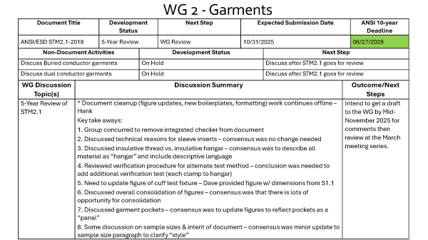

The WG reviewed STM2.1 for the 5-year review. Possible revisions include:
- There was a discussion on voltage leakage of cables.
- Developed measurement system verification procedure.
- Removed sections from ANNEX that had misinformation.
- Removed procedures that were compliance verification tests.
- Identifying required measurements for each garment level.
The group reviewed ANSI/ESD STM2.1 for 5-year updates. Need to add an additional procedure for garments in the Groundable Garment category with knit cuffs and update photos/figures.
